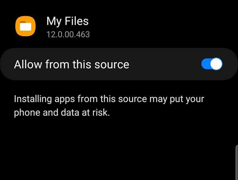

Nes
I think you are talking about this, if so I am still not able to install
