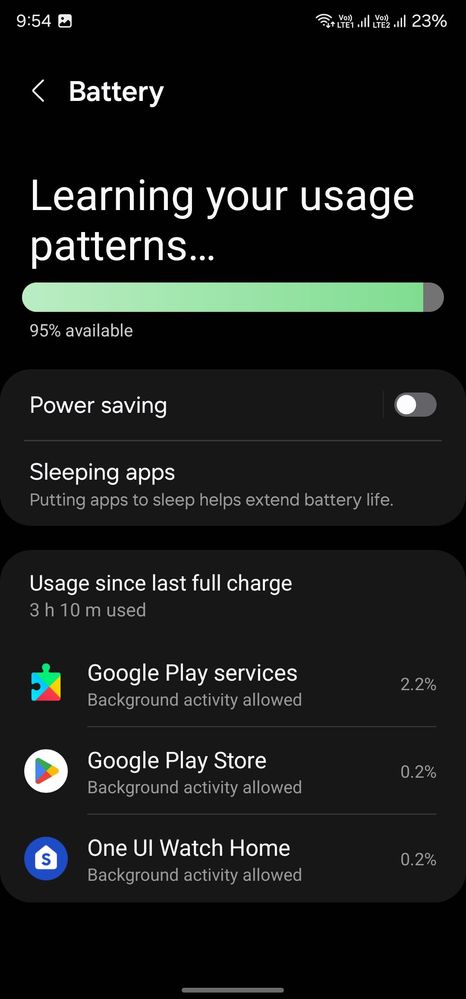

I recently purchased Galaxy watch 5 Pro LTE from Samsung Shop. They sent 15 months old (MFD: August 2022) device. And the battery is totally dead at the time of arrival. Anyhow i setup the device and started using it. This watch has 590mAh battery and most of the YouTuber claimed it gives 4 days of battery life and even Samsung says 80hrs usage in their website.
Unfortunately I'm getting only 2 days of battery same like my 2 year old watch 4.
I went to service center for DOA. But service center denied and simply re-flash the software. After tested multiple times. No use.
I turned off AOD, auto brightness, mode sync, location, notification except call notification, all sensors(set manually) and disable Bixby, Google assistant. Also not setup LTE
But when I checked the battery drain lost, the Google play services and one UI home drains the battery always. I don't know whether Samsung going to push software update to resolve this issue.
Totally disappointed with the device.

S_Kumar73
Wearables
I did all. Only thing I didn't do was not switch off the watch.
Poorly optimised watch software.
