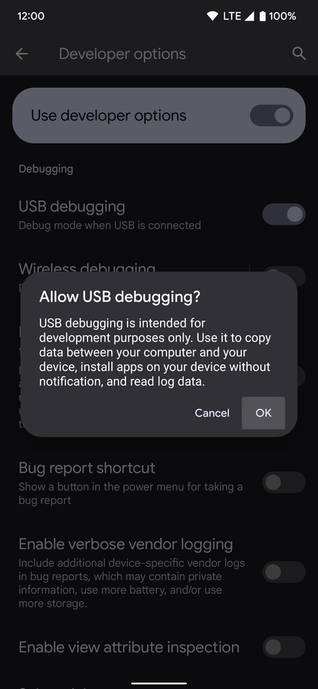

Download the latest Android SDK platform-tools and extract the folder to your desktop for easy access.
  1. Install the Google USB drivers if needed (for Windows users).
  2. Enable USB debugging on your Android device.
  3. Open the Settings app, then go to System → Developer options.
  4. Scroll down and tap the USB debugging option.
  5. Press OK to enable.
  6. Connect your phone to your computer via a USB cable.
  7. On your Android device, confirm the fingerprint key for the computer by pressing Allow when required.
    • Check the Always allow from this computer box to avoid any potential connection issues.Open a command window or terminal in the platform-tools folder.
      • If you're using Windows, you click the address bar in the platform-tools folder, type cmd, and press Enter. This will open a new command window directly in the platform-tools folder.Just as with the wireless debugging feature, you must reactivate the Shizuku service each time you reboot your device. These two methods rely on the ADB interface, which only makes temporary changes to your device without root access. Since you don't need to reboot that often these days, it likely won't be an issue for most.
      • Check your Shizuku app at the top, and you'll see the Shizuku is running status with a version number followed by adb.If you want to use Shizuku in a terminal environment on Android, you can follow the in-app instructions by tapping Use Shizuku in terminal apps. It'll ask you to export and edit two files with the package name of your terminal app. Move them to a place where the terminal can find them. This is an advanced feature for people who like working with a command-line interface, so the average user likely won't mess with it.
