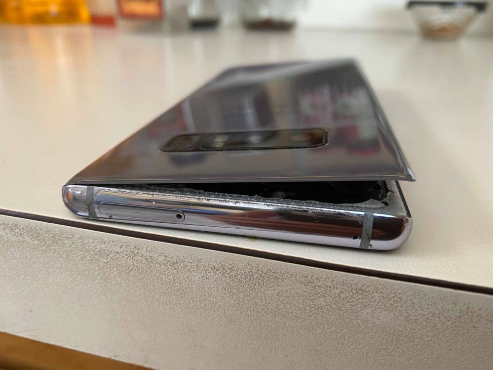

Hi...,
Happen to my phone... Does anyone have the issues with the back cover of Samsung note 8 pop out and the battery getting hot? Thanks117715125_1013662392400732_7956567931236882533_n.jpg117893769_297861938110210_2500436125099091596_n.jpg117907295_771743323639889_1407245586397879134_n.jpg118319612_2765046667063778_4068166943623108127_n.jpg

you have to change the battery. looks like it got damaged

you are lucky that the back glass not broken. it's because of battery bulge. Replace the battery immediately..

Your battery has got bloated which has expanded and made your back cover to open. Visit SC and replace battery and they will fix your back cover
