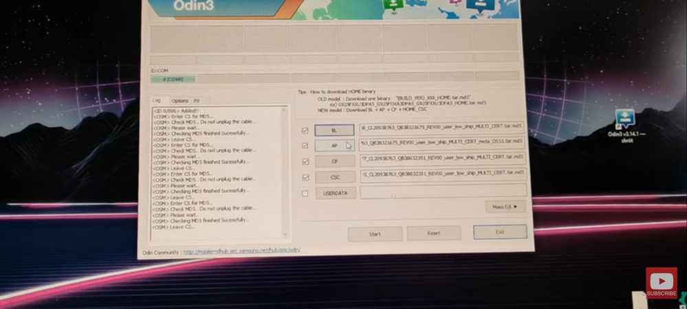

Install Odin any version
Open Odin
Unzip the downloaded flimware
Switch off your phone
Plug it in laptop then press volume up and down button at same time then download mode will open
Your device will appear in Odin
Attach each files with Odin
Attach csc file not home csc file in 4th attachment box
Csc mean full wipe data will be deleted
Home csc mean data, apps will be there but it may cause some issue while boot up or software issues due to os compatibility
Finally press start
If you did all above process correctly then it will start downloading in phone or else it will throw any error.
