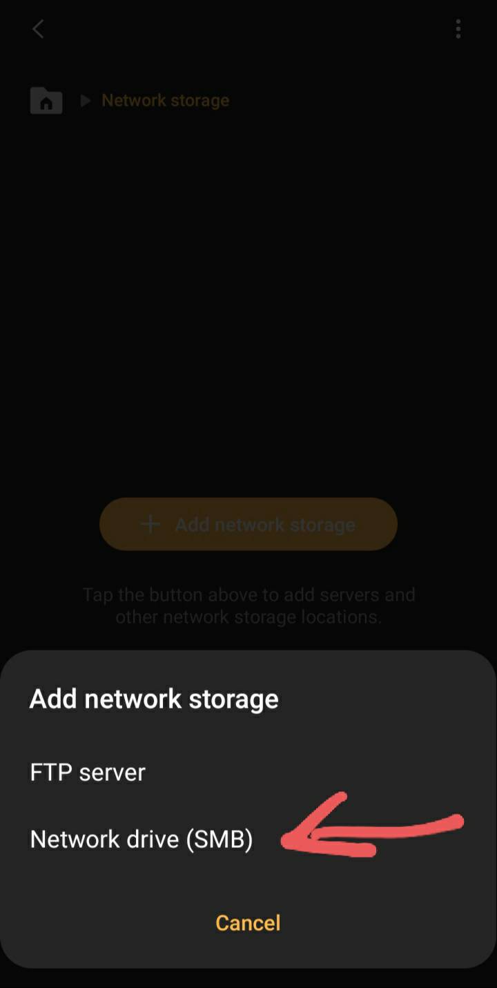

Go to My files -> Network storage -> Add network storage -> Select Network Drive SMB ( Your phone will search for drives on WiFi network) -> Select the network drive -> Enter login credentials if needed -> Then click on add button to finish the process .
You can view the shared drive folder & file which can be opened & downloaded to your phone .
Let me know if you able to access your hard disk by following this method .
